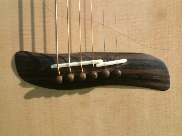

PostPosted: Tue Nov 07, 2006 10:37 pm
Andy,
It all depends on scale length, tunings, string gauges etc, and I have found a split saddle works best for me. I also do it a bit like Michael - from trial and error on my different instruments I have worked out the points of intonation for each string and then worked out the angles for the split saddles that connect these as near as possible to give the intonation point as close as possible to the centre of the saddle. Unlike Michael I don't cut the slot with the bridge attached but use different jigs based on the model I am building.
For a guitar with scale length (defined as twice the distance from nut edge to middle of 12th fret) between 635mm and 655mm (25" and 25.75"), with 0.012"-0.053" gauge strings the following rule of thumb works pretty well for me:
Length of string from edge of nut to saddle break point in addition to scale length from high to low: 2mm, 0mm, 2mm, 4mm, 6mm, 7mm.
I have the low 6th string further back than many I suspect as I have this string usually tuned down to D or C. Here's a pic of the saddles with such a set up:
